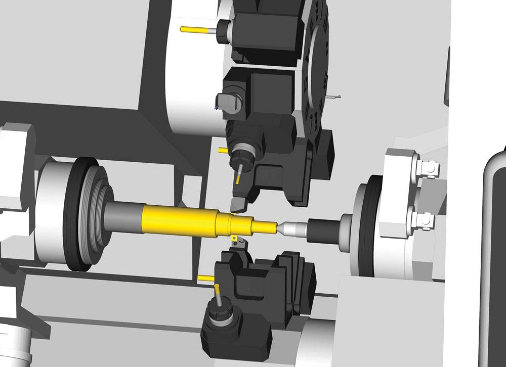

Are two tools better than one? That is a question that many shops interested in pinch turning may ask themselves. But the answer is not a simple yes or no. Pinch turning may sound complicated, but with the right specifications, this operation can be done easily and effectively, cutting cycle time almost in half.

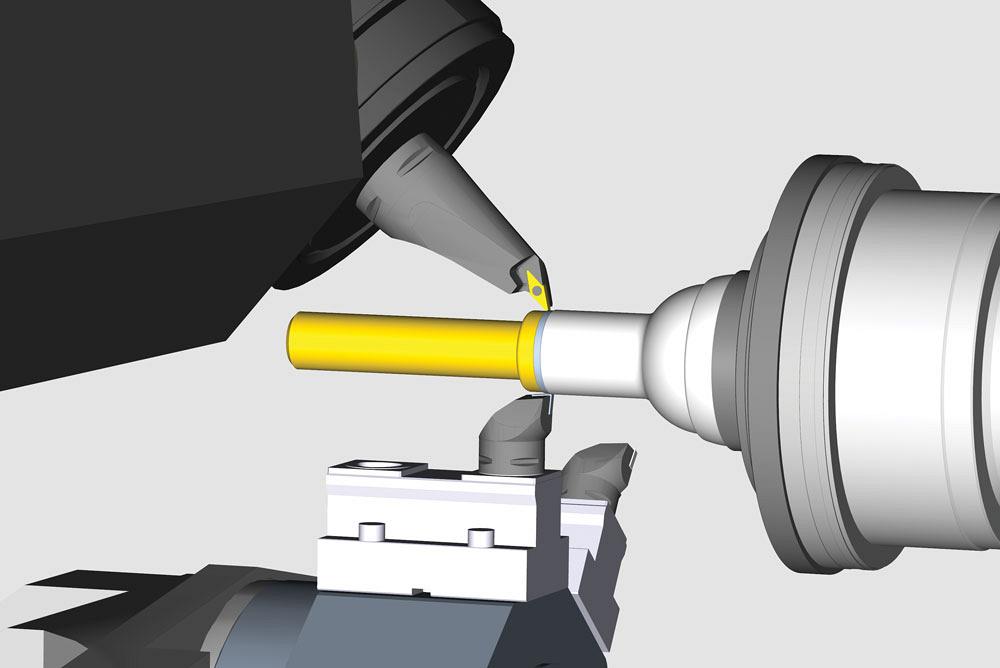

This operation basically allows two tools to access the part simultaneously, one on the top spindle coming down straight and another on the bottom turret coming in at an angle. The tools are staggered, with the second tool coming in at a slightly offset Z-axis position.
For example, with a normal OD pass, the depth of cut (DOC) is split between the two tools during a single pass. The first tool will be positioned for a 0.05-in. DOC, while the second staggered tool—at 0.125-in.offset in Z—will be set for a 0.1-in. DOC. Cycle time is essentially cut in half because the machine is performing two passes at once.
“With pinch turning, the goal is just to go faster and pull off more material in the same amount of time,” said Nick Zentil, director of North American sales, Hexagon Manufacturing Intelligence, North Kingstown, R.I. “Another advantage is its ability to minimize deflection.
When a tool is cutting on one side of the part, there is the risk, especially with long, slender parts, to bend. However, with two forces pushing on both sides, this can reduce the risk of deformation.”

Some manufacturers use the terms pinch turning and balance turning interchangeably. And while these two processes function similarly, there are slight differences between the two. While pinch turning requires two tools to engage the part, balance turning requires the upper spindle and lower turret to engage the part at exactly 180 degrees from each other.
“With balance turning, the tool is able to equalize the passive force of the tool on the direct opposite side of the part during the cutting process,” said Robert Keilmann, senior global product manager for turning, Kennametal, Latrobe, Pa. “Pinch turning, on the other hand, does not require the spindle and the turret to be 180 degrees apart, and therefore does not have the same benefit of passive force equalization. However, it can be applied in applications where high metal removal rates are needed in a short amount of time, making the machine much more cost-effective as it can remove material twice as fast with a shared DOC. Balance turning, with specific machine requirements, is particularly beneficial in thin-walled components or long parts where there is a lack of stability.”
For the most part, balance turning requires that the upper and lower tools cut the same profile at the same DOC simultaneously. Both tools are essentially at the same Z axis, and the toolpath is split between the two tools, allowing for the feed rate to be almost doubled. Pinch turning, alternatively, doubles the DOC, not the feed rate.

Dual-tool Operations. In a dual-tool operation, during the pinch turning process, both tools are performing the same operation and use the same insert type. For example, on the roughing side, two roughing inserts would be used, slightly offset from one another, and perform the pass staggered, allowing for that larger DOC.
“This is really the easier method of the two,” said Jan Andersson, director of product management, indexable inserts for Americas, YG-1 Canada, Burlington, Ont. “It’s relatively easy to split the larger DOC between the two inserts. With this method, it’s also important to ensure proper synchronization between the upper and lower turret. But one thing you need to be aware of is chip control because you cannot afford to pinch turn with chip control issues.”
The advantage of this process is that you can essentially double the DOC because it removes one pass from the process.
